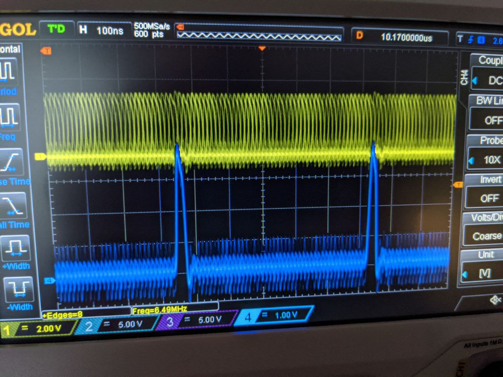

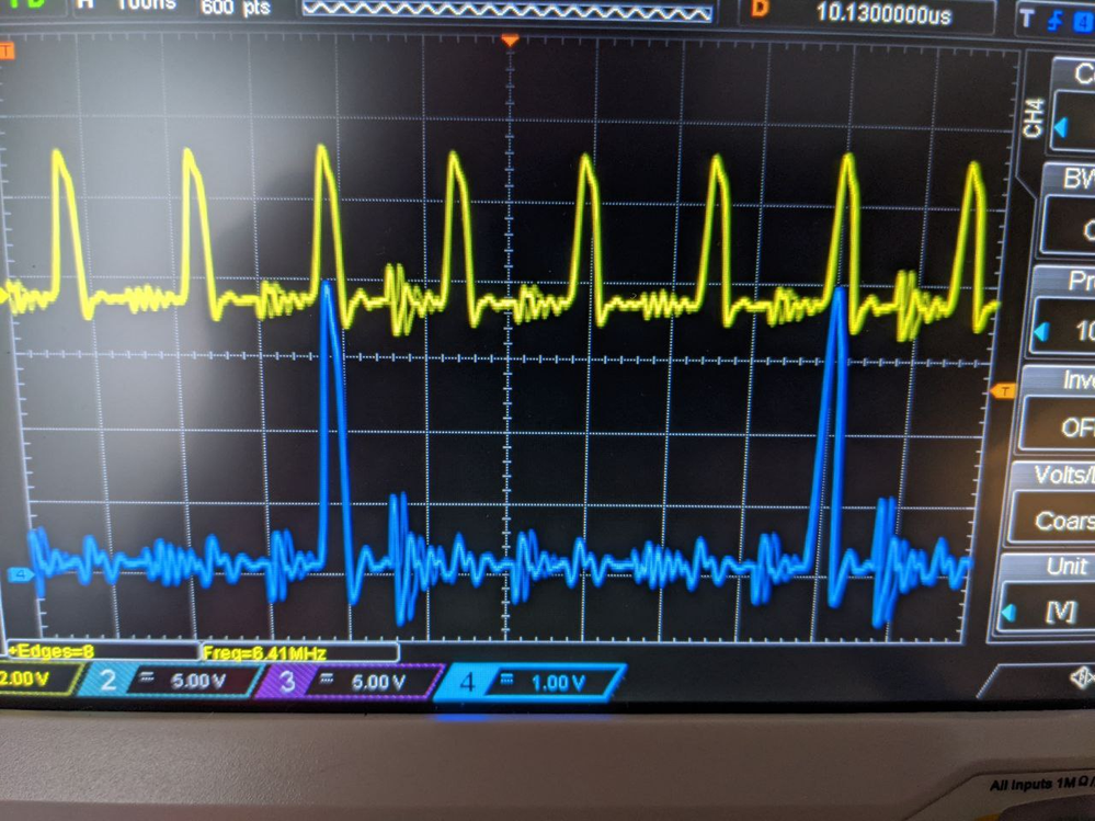

Looking at it on a scope, without this extra addition the pulses don't sync --- i.e., TIM1 bounces around relative to TIM2.
