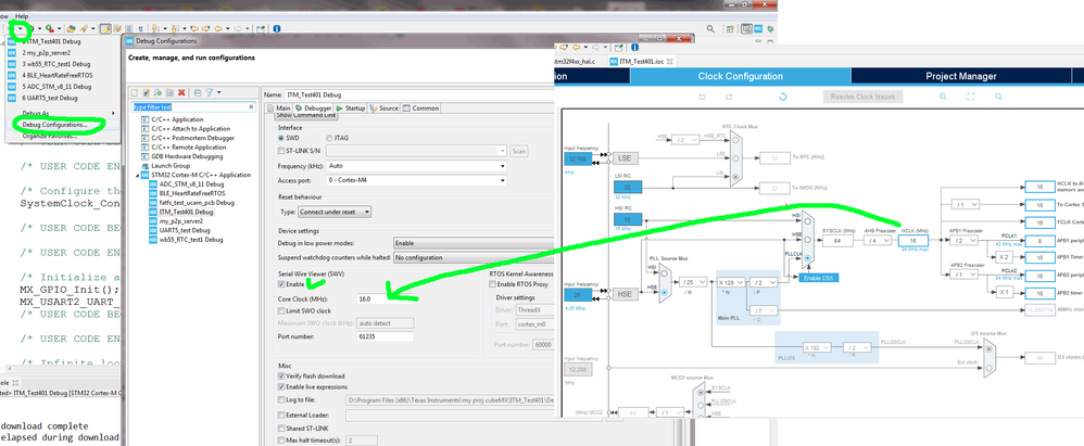

}[x] Enable
Core Clock 16MHz
SWO Clock: 2000 kHz
Port number: 61235
[x] Wait for sync packetTab "SWV ITM Data Console"

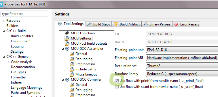

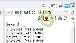

This is ITM example with printf float via ITM.
Also "Output gets flushed on reaching newline character or calling fflush(stdout) function. Additionally there is an option to disable buffering entirely by calling setbuf(stdout, NULL)."
main source: AN4989
