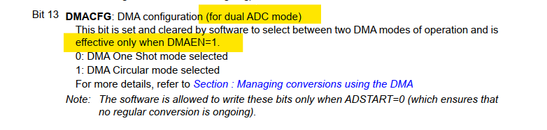

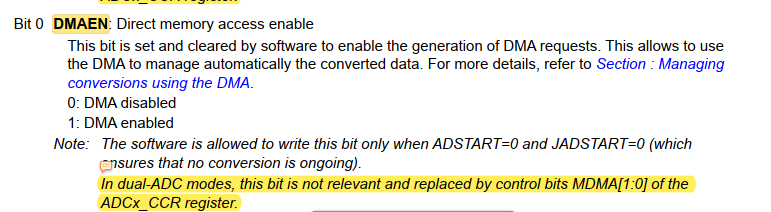

In dual ADC mode, the bit DMAEN is invalid as the doc said but in the below screenshot it is describing that the DMACFG bit in ADCx_CCR is effective only when DMAEN = 1.
Need help from you whether I am right or not? And I just want to know proper procedure to do.

This  is a typo: this should be MDMA instead of DMAEN
In the ADCx_CCR DMACFG, it should indicate “effective only when MDMA[1:0] != 0�?.
I have raised the error internally for fix .
