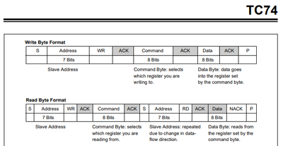

2023-10-14 9:36 AM
How to use HAL_I2C_Mem_Write/Read in this case for TC74? There is no separate variable for Command and Data as shown below.
2023-10-14 12:32 PM - edited 2023-10-14 12:39 PM
Read (the lower picture):
uint8_t data;
HAL_I2C_Mem_Read(hi2c, DevAddress, (uint8_t)command, 1, &data, 1, timeout);
Write does not have repeated start so can use HAL_I2C_Master_Transmit as well. Or:
uint8_t data = ...;
HAL_I2C_Mem_Write(hi2c, DevAddress, command, 1, &data, 1, timeout);
