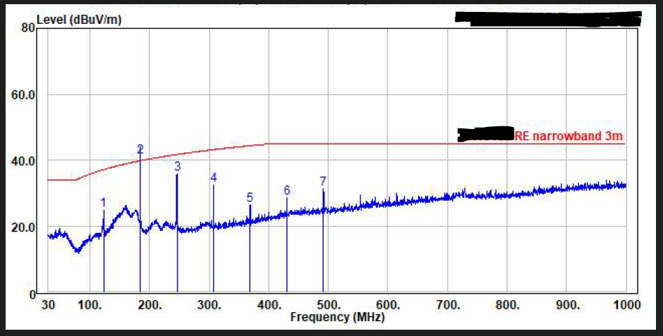

1. Far-field EMI, as shown in the figure below

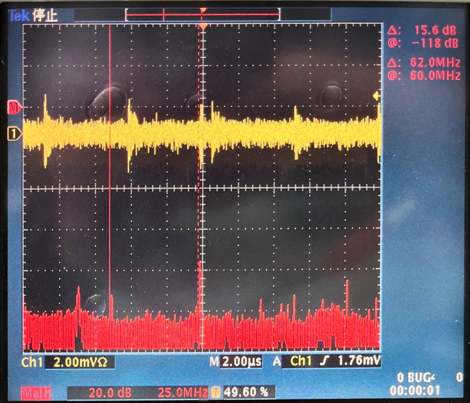

2. MCU Near-field FFT, as shown in the figure below(EVM also has this situation)
3. External power connection, as shown in the figure below
4. Use a scope carbon rod and use a ground spring. It is measured that all output signals of the Gate driver have a main frequency of 60Mhz.

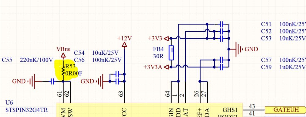

5. After I removed the R53, I found that the MCU near-field FFT 60Mhz disappeared immediately.

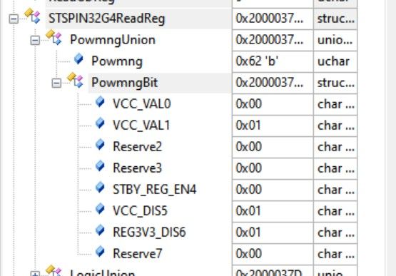

6. Check whether the Buck reg is closed
7. How can I double confirm that the Buck reg has indeed been closed?
