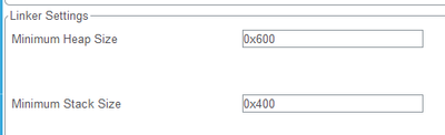

If I recall correctly, one must make sure that the stack size is big enough when using USB. If it isn't, then you may see all sorts of strange beaviour.

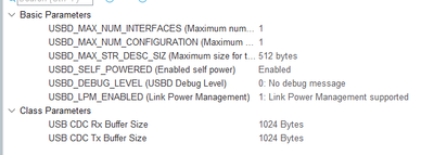

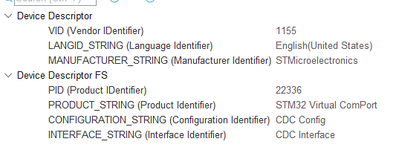

Just in case it could be helpful, this is the setup of my USB port:
Heap and stack size, although I am not certain that the heap is being used:

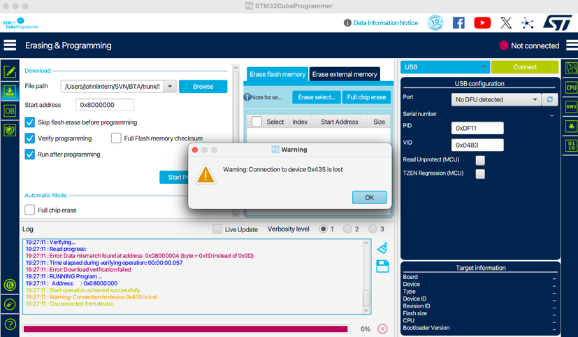

However, when I try to flash a simple application .bin file (that just flashes an LED) I get the following errors...
The log shows the following...
19:21:21 : STM32CubeProgrammer API v2.20.0 | MacOS-64Bits
19:21:34 : USB speed : Full Speed (12MBit/s)
19:21:34 : Manuf. ID : STMicroelectronics
19:21:34 : Product ID : STM32 BOOTLOADER
19:21:34 : SN : 207C30AC5533
19:21:34 : DFU protocol: 1.1
19:21:34 : Board : --
19:21:34 : Device ID : 0x0435
19:21:34 : UPLOADING OPTION BYTES DATA ...
19:21:34 : Bank : 0x00
19:21:34 : Address : 0x1fff7800
19:21:34 : Size : 36 Bytes
19:21:34 : UPLOADING ...
19:21:34 : Size : 1024 Bytes
19:21:34 : Address : 0x8000000
19:21:34 : Read progress:
19:21:34 : Data read successfully
19:21:34 : Time elapsed during the read operation is: 00:00:00.031
19:22:00 : Opening and parsing file: STApplication.bin
19:22:00 : Memory Programming ...
19:22:00 : File : STApplication.bin
19:22:00 : Size : 6.13 KB
19:22:00 : Address : 0x08000000
19:22:00 : Download in Progress:
19:22:00 : File download complete
19:22:01 : Time elapsed during download operation: 00:00:00.086
19:22:01 : Verifying...
19:22:01 : Read progress:
19:22:01 : Error: Data mismatch found at address 0x08000004 (byte = 0x1D instead of 0x0D)
19:22:01 : Time elapsed during verifying operation: 00:00:00.057
19:22:01 : Error: Download verification failed
19:22:01 : RUNNING Program ...
19:22:01 : Address: : 0x08000000
19:22:01 : Start operation achieved successfully
19:22:01 : Warning: Connection to device 0x435 is lost
19:22:01 : Disconnected from device.

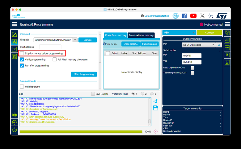

UPDATE;
Unticking "Skip flash erase before porgramming" fixed it...
So the simple application seems to work, now I need to implement it in my actual more complicated project.
