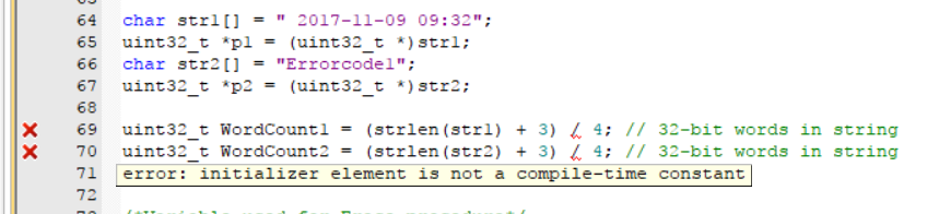

In the flash memory as shown in the following code, the str1 and str2 values are divided into 4 bytes
I want to write down. I have an error like the image I captured .;When I have an event, I write it to Flash and try to read it.
Help me ioi ;;

2017-11-19 6:43 PM
Then use sizeof() or compute rather than assign.
ie
uint32_t WordCount1, WordCount2;
WordCount1 = (strlen(str1) + 3) / 4; // 32-bit words in string
WordCount2 = (strlen(str2) + 3) / 4; // 32-bit words in string

Put it within the same compound statement you have the while() loops sitting in
