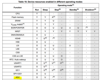

2024-06-18 12:43 AM
Hello @uveuvenouve,
Waking up from shutdown mode using ADC events is not typically supported because the ADC is already powered down in shutdown mode, Please check this table in RM0490:

On the table ,it state "U" in sleep mode for ADC, which is unchanged.
The point is i want to deploy a function that adc wake the mcu from sleep mode with low layer lib, but I can't find examples.

You can use either the __WFE(); or __WFI(); instruction to enter sleep mode
the note "Unchanged" in Sleep mode means that the peripheral retains its state or configuration and continues to operate as it did before entering Sleep mode so it is possible to use it.
