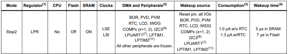

Some peripherals can be kept running during Stop2, others are frozen. This is what we see summarized in following table:
This table is extracted from AN4621 STM32L4 and STM32L4+ ultra-low-power features overview.
Please review it in order to understand more about the low power modes for STM32L4 products.
If there is still some troubles, please explain more the problems you are facing. You shouldn't expect the same behavior with Stop & Sleep modes, they are different.
