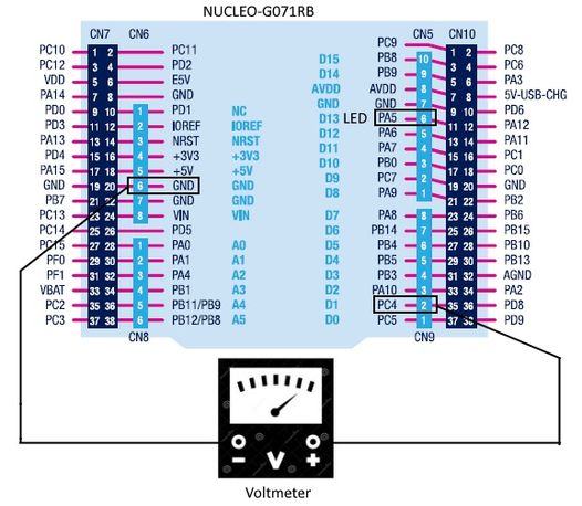

The output voltage before and after entering Standby Mode was measured with a voltmeter (Figure 1).
Figure 1. Pinout of the NUCLEO board.
