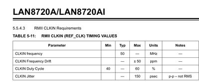

I considered that the issue might be related to the CLK (clock) settings. The LAN8720A datasheet recommends using a 50MHz clock source with RMII. However, when I set MCO to 50MHz, I encounter problems such as failing to get the PHY address and being unable to read or write to PHY registers.

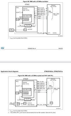

To provide more context, I have attached the schematics for STM32F745ZG and the diagrams for REF_CLK_In mode. In the schematics PA1 connected to MCO. In CubeIDE pinouts PA1 is ETH_REF_CLK. That's why I think I should use REF_CLK_In mode.

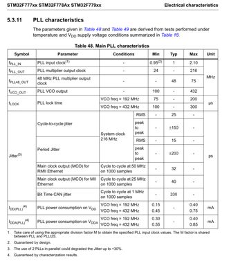

it may be a tolerance / sensitivity on Jitter between the MCO output ( after PLLs) and overall I/O load vs the PHY requirement. Here some screenshots on STM32 datasheets and PHY on the clock required for RMII at 50MHz . You may probe it as well to check with low capacitive probe on oscilloscope.
