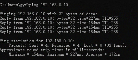

Everything's fine at this point : I can ping 192.168.0.10 and get replies.

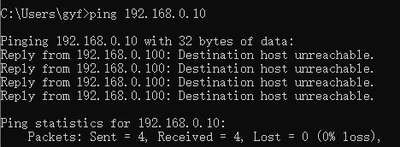

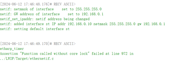

However, after I Modify the StartDefaultTask in main.c , I can't ping the device and get some debug information from uart :
How to deal with "core lock " in the debug information ?

Hello @Hamaos ,
Try to add the following:
these macros and prototypes are for proper multithreading support
add in your ethernetif.c the following:
#undef LWIP_PROVIDE_ERRNO
#define LWIP_ERRNO_STDINCLUDE
/* ETH_CODE: macro and prototypes for proper (hopefuly?)
* multithreading support
#define LOCK_TCPIP_CORE sys_lock_tcpip_core
#define UNLOCK_TCPIP_CORE sys_unlock_tcpip_core
#define LWIP_ASSERT_CORE_LOCKED sys_check_core_locking
#define LWIP_MARK_TCPIP_THREAD sys_mark_tcpip_thread
void sys_lock_tcpip_core(void);
void sys_unlock_tcpip_core(void);
void sys_check_core_locking(void);
void sys_mark_tcpip_thread(void);/* ETH_CODE: add functions needed for proper multithreading support and check */
static osThreadId_t lwip_core_lock_holder_thread_id;
static osThreadId_t lwip_tcpip_thread_id;
void sys_lock_tcpip_core(void){
sys_mutex_lock(&lock_tcpip_core);
lwip_core_lock_holder_thread_id = osThreadGetId();
void sys_unlock_tcpip_core(void){
lwip_core_lock_holder_thread_id = 0;
sys_mutex_unlock(&lock_tcpip_core);
void sys_check_core_locking(void){
/* Embedded systems should check we are NOT in an interrupt context here */
LWIP_ASSERT("Function called from interrupt context", (SCB->ICSR & SCB_ICSR_VECTACTIVE_Msk) == 0);
if (lwip_tcpip_thread_id != 0) {
osThreadId_t current_thread_id = osThreadGetId();
#if LWIP_TCPIP_CORE_LOCKING
LWIP_ASSERT("Function called without core lock", current_thread_id == lwip_core_lock_holder_thread_id);
/* ETH_CODE: to easily check that example has correct handling of core lock
* This will trigger breakpoint (__BKPT)
#warning Below check should be removed in production code
if(current_thread_id != lwip_core_lock_holder_thread_id) __BKPT(0);
#else /* LWIP_TCPIP_CORE_LOCKING */
LWIP_ASSERT("Function called from wrong thread", current_thread_id == lwip_tcpip_thread_id);
#endif /* LWIP_TCPIP_CORE_LOCKING */
LWIP_UNUSED_ARG(current_thread_id); /* for LWIP_NOASSERT */
void sys_mark_tcpip_thread(void){
lwip_tcpip_thread_id = osThreadGetId();
}Hope this helps you.
