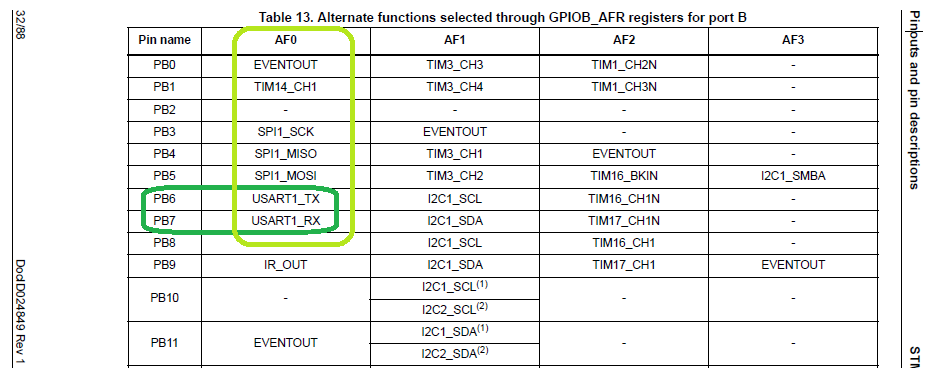

Try GPIO_AF_0 for PB6/PB7
Good call laurent Something that would have been caught by observing the pin, and reviewing the manual for the part.2014-04-07 7:16 AM
http://www.st.com/st-web-ui/static/active/en/resource/technical/document/datasheet/DM00088500.pdf
