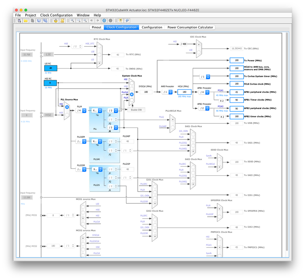

The way I confirm the clock is really running at 180 MHz is to put a scope on PC_9 to see 90 MHz and include this call in the code:
HAL_RCC_MCOConfig(RCC_MCO2, RCC_MCO2SOURCE_SYSCLK, RCC_MCODIV_2);
Here is a screen shot of the setup:
2016-12-07 8:47 AM
Ok, so the use of HSI seems to have precluded the use of USB, but the default settings need to bring the 48 MHz clock to some semblance of normality. The PLL taps are going to clock regardless of whether the source clock is HSE or HSI, the HSI+PLL clock is just not going to be stable enough to use for USB, but isn't the CRYPT+SDIO still using that clock, and viable?
Pretty sure there isn't an OFF setting for the individual P, Q and R taps, just if the PLL is enabled, or not.

2016-12-07 8:51 AM
What does this mean? Why 8?
2016-12-07 8:53 AM
I think this is a bug
Downey.Elwood
ran into when this, or the prior thread was opened. The Clock Tree view needs somefixing and thought.Edit: This one
https://community.st.com/0D50X00009Xke6cSAB
