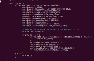

I am using an stm32wb55 neucleo board for a wearable based project. I am using ADC1-IN1 to read the adc raw value from MCU pin PC0 of wb55 board. A voltage divider circuit was connected to scale down the BAT voltage from (4.2-3.7) to (1.8-1.585).

1. Yes, Calibration is done.
2. Yes, 100k and 75k resistors in dividor network.
sampling time : ADC_SAMPLETIME_12CYCLES_5
