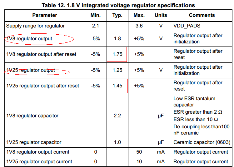

I try to use ST flash loader to connect the board, but fail. The I measure the VREG_OUT is 1.786V and the VDD_CORE is 1.497V. That's incorrect.
Acoording the datasheet, my board maybe just reset but not initialization?

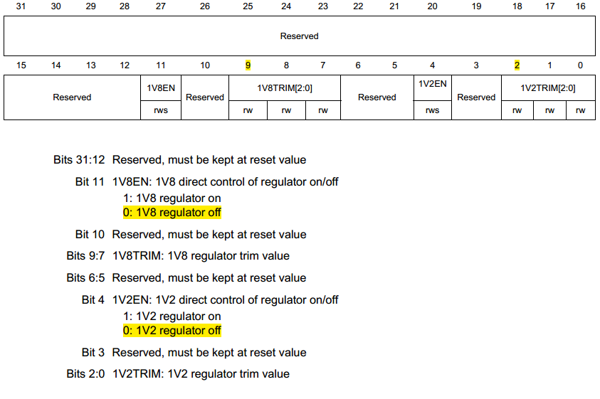

Is the internal regulator the default Core power supply? Or how to initialize it.
