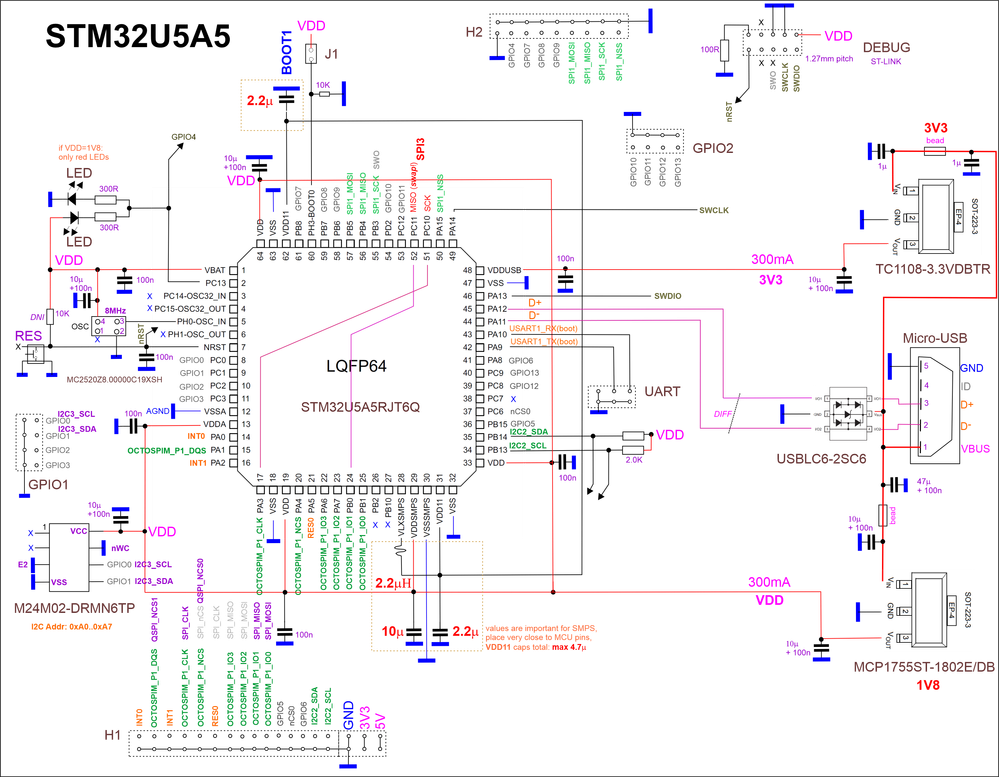

Now I have a shared use of the OCTOSPI pins (as QSPI), also like a "regular SPI" (e.g. changing to full-duplex, bi-directional SPI slave connected).
See my schematics for it at the end:
connect SCK from OCTOSPI Master to SPI3 Slave SCK and listen on OCTOSPI IO1 as SPI3 Slave MOSI (RX). It works (up to 40 MHz).
The project is here (for my own PCB, on NUCLEO board you need two flying wires):
https://github.com/tjaekel/NUCLEO-U5A5JZ-Q_QSPI

See, that I am expecting to get two bytes at the beginning (CMD with data0 and regular data1), sent by the OCTOSPI TX when starting the transaction.
Schematics:
Here the schematics I use on my PCB (SPI3 is a Slave listener on OCTOSPI signals). On a NUCLEO board you need external wires to accomplish the same (see the pink traces under the STM MCU chip, on NUCLEO board as flying wires).
Only this gives me a REAL "regular" SPI on OCTOSPI (with sharing the same pins).
