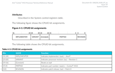

2024-02-02 2:01 AM - edited 2024-02-02 7:50 AM
Hello @tjaekel
Sorry for the inconvenience. CPUID registers are detailed in the Arm® Cortex®-M33 Processor Technical Reference Manual

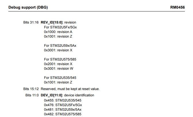

2024-02-02 7:38 AM - edited 2024-02-02 5:37 PM
The reference manual says nothing about REVID and CPUID.
Edit: but it does say stuff about REV_ID and DEV_ID, which is what you want.
2024-02-02 3:02 PM
Sorry,
"Check section 76.1 in the reference manual: Unique device ID register (96 bits)" (not seen here as response, but I got it in my email) - it is NOT what I was talking about (I know this register: useful for USB IDs, ETH MAC addresses, ... I have used already on other projects).
Yes, I know this ARM document where I can figure out it is a CM33 (this 0xD21). The CPUID is clear for me.
I was asking about the REVID, which seems to be different, depending on U5A5 vs. U575.
I want to know if it is a U5A5 or a U575 (not just if CM33).
REVID register is not documented (and CPUID coming from ARM specification/doc is not mentioned, but obvious for me as part of the ARM IP used).

2024-02-02 4:37 PM
2024-02-02 7:26 PM
Wau, cool. Thank you very much
(exactly what I was looking for)
Best answer I ever got in this forum...
