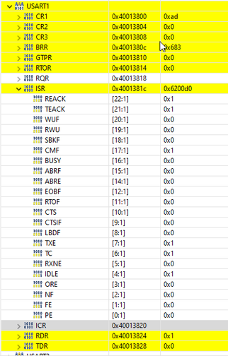

2024-01-30 3:53 AM
What I have noticed is if I clear the flags before checking the RXNE flag, then the RXNE gets cleared. If I put at the end then works as expected. I am thinking I dont even have to check this flag as I dont use this feature.
void USART1_IRQHandler(void)
unsigned char data;
if(USART1->ISR & USART_ISR_FE)
USART1->ICR |= USART_ICR_FECF;
if(USART1->ISR & USART_ISR_EOBF)
USART1->ICR |= USART_ICR_EOBCF; <<this clears the RXNE bit
if(USART1->ISR & USART_ISR_RXNE) //RX interupt
data=USART1->RDR;
Below is the snap shot prior to moving the above to the end..
