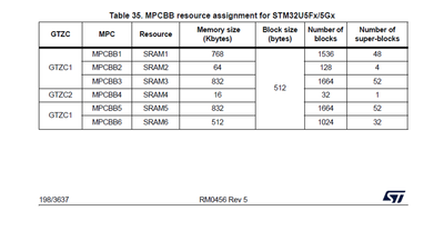

1. Hardware Support for Large SRAM in STM32U5G9
  • The STM32U5G9 device features multiple SRAM blocks (e.g., SRAM1 = 768 KB, SRAM3 = 832 KB, etc.) controlled by separate MPCBB instances.
  • Each MPCBB instance manages a maximum of 512 KB blocks (block size = 512 bytes, number of blocks accordingly).
  • The hardware supports multiple MPCBB controllers (MPCBB1 to MPCBB6) to cover all SRAM regions, including those larger than 512 KB.

After looking at the code and Section 5.8 of RM0456 Rev 5 more closely, it looks like the comment just isn't accurate.  The code works for the 832 KB and 768 KB SRAM resources supported on the STM32U5G9.
