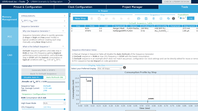

in IDE/CubeMx is also a power calculator: set what you want and make a some ms step - then you see...
-> New Step -> then set your peripherals , that you use ...

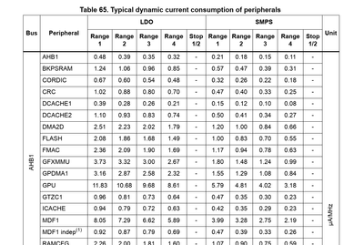

So look in ds and add all together + cpu ... but why not using Cube ? Too easy ?
see ds ...4 pages !!!!
