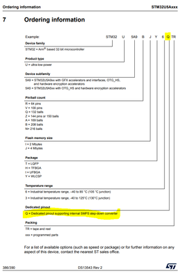

Hello @Sakthi_IND
To know the devices implementing SMPS, you have to Follow the Ordering name specifications as you can see here:
Best Regards.
STTwo-32
With only specifying "STM32U5A5QJ" you miss at least 2 letters and a third letter 'Q' if you want the SMPS variant. On the webpage at the moment only "STM32U5A5QJI6Q" is in stock,  with 'I' for UFBGA an '6' for 105 max junction temperature and 'Q' for Dedicated pinout supporting internal SMPS step-down converter
