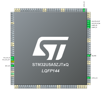

When I see my NUCLEO-U5A5 project (using OTG USB HS:(
- it does NOT configure any PA11, PA12 (nothing for PA11, PA12, no ALT needed neither used)
- instead, it enables in function "void HAL_PCD_MspInit(PCD_HandleTypeDef* hpcd)" only the USB HS
So, it looks to me as:
PA11, PA12 are implicitly used as USB_DP, USB_DM when USB HS is enabled (therefore "other functions"):
no need to configure PA11, PA12 via an ALT (not available): it is done (used) automatically via USB HS enabled
But it means also:
on U5A5 PA11, PA12 become USB HS signals now: all my code for FS on 575 has to be changed to use USB HS (and internal PHY)
BTW: very cool that STM MCU has now an internal USB HS PHY! (but obviously just on U5A5). Anyway - very great and I appreciate it. Long time awaited feature, well done.

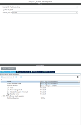

b) if changing to U5A5 and PA11, PA12 become OTG_HS_DM, OTH_HS_DP now: does it mean I have to configure now USB HS instead of USB FS (as on U575)?
You can configure the USB HS to work as a USB FS using the internal HS physical interface.
c) how to configure ALT function of USB_HS (if not listed in table) for U5A5?
You can refer to one of the examples in the STM32Cubeu5.
