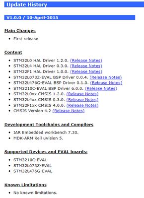

Then, I checked the possible IAP implementation and I reached the AN4657, but it seems quite old and without CubeIDE examples or latest STM32 MCU families implemented:
