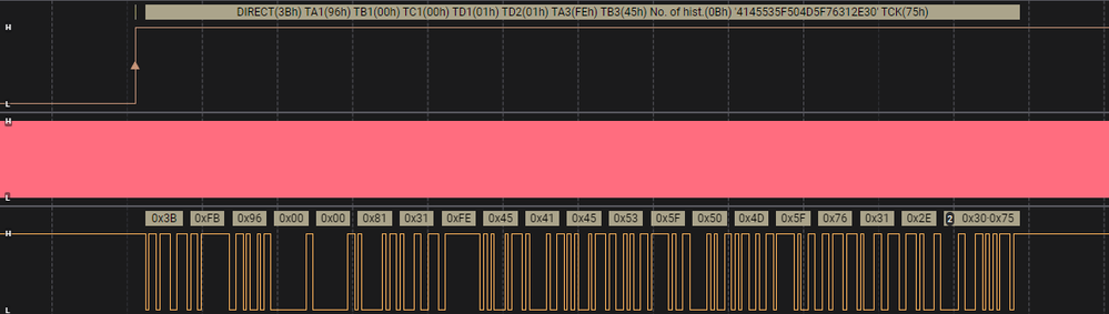

We are testing the STM32U585 Smart Card mode with clock and trying to connect with external SAM module. We are able to get the USART-ISO7816 frame format from the controller but we are unable to capture the ATR value from the module in a correct manner. From the logic analyzer with the setup connected we are getting correct ATR values but inside the controller the ATR values are in the wrong format. Following is the expected card ATR response:
This waveform is obtained from the card reader connected to the STM32U585 board. and the ATR waveform is the correct format as described in the standards. the same signals we are capturing in the STM32U585 debug mode and getting the data as shown in the below figure.

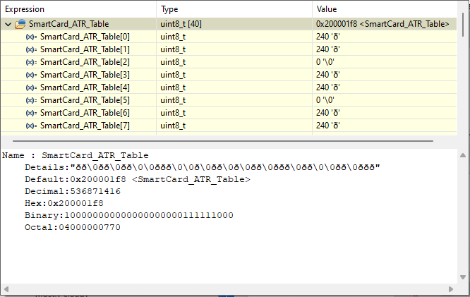

2023-06-26 7:05 AM
Values in SmartCard_ATR_Table are 240, 240, 0, 240, 240, 0, ... It seems values are 'noise'. The memory was not written and have previous values. How many bytes do you receive?
If this is not the case, maybe baud rate or smartcard clock are wrong. But I believe this is not the case due to the sequence 240, 240, 0.
The logic analyzer is configured with baud rate 9600 or it auto detects the baud rate?
2023-06-26 9:56 PM
Hi @AA1
Greetings
The logic analyzer detects the baud rate automatically. I think it is some configuration mistake in STM side and that's the reason of not able to receive correct baud rate.

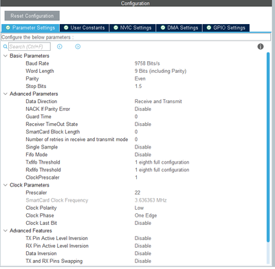

2023-06-27 2:31 AM - edited 2023-06-27 2:31 AM
We have tried with 9758 baud rate and 3.75Mhz clock frequency based on the calculation as shown below:
Fi = 372
Di = 1
ETU = 372/1 * (1/3.63x10^6) = 0.00010247 usec
f = 1/T = 1/0.00010247 us = 9758 bits/sec
The Cube MX configuration setup is as shown below:
And the clock supplied for UART3(SmartCard) is 160MHz
Thanks
Pjose
2023-06-27 7:09 AM
Hi @PJose.4
This looks correct. I didn't get exactly same value, but I'm not sure it could explain the issue.
I'm trying to explain the method i used.
In your project, you have USART3 clocked with PCLK1 at 160Mhz. On this, a Prescaler (value 22) is applied, leading to have SCLK signal supplied to Smartcard equal to 160/(22*2) => 3.63Mhz.
At startup, communication with smartcard will be based on a F/D ratio of 372/1 (372 clock cycles per etu).
This 372/1 ratio in U5 SMARTCARD ip (USART3) is achieved by implementing a corresponding baudrate of 3.63/372 => 9775.
So in my opinion, I think the exact value of the baudrate to be set in USART3 configuration in Smartcard mode, with a initial clock of 160Mhz, a prescaler equal to 44 (22*2), should be 9775. Not so far from 9758. Sorry :(
For reference, you could have a look at a Smartcard example available on STM32U575 Evaluation board, that is available here.
In this case HSI 16Mhz is used, divided by 4 (prescaler = 2), which provides a 4Mhz clock to the smartcard : baudrate set to 10752 (equals 4.000.000/372).

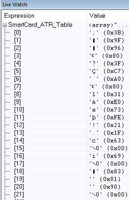

2023-06-27 11:51 PM
Hello @Guenael Cadier,
I have also tried with different microcontroller NUCLEO-STM32U575-Q board. With the configuration mentioned for (ComDMA) i.e 4Mhz @ 10752 bps. Still we are getting same data. PFA for the same.
Waveforms captured via logic analyzer
Data read from u575 STM board
Regards,

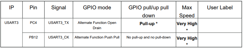

2023-06-28 8:52 PM
I wanted to know if you are getting this output by using ST8024 IC. As I have researched there is a 11k internal pullup on IOUC line. So can you please let us know what is the configuration done for the same.
This is my current configuration
Regards,
