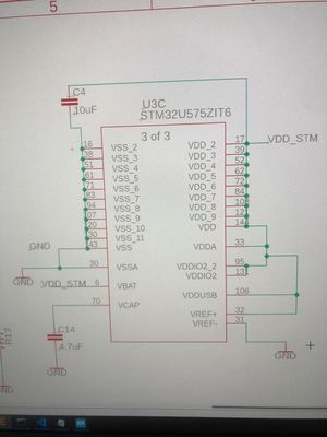

I am currently working on a custom PCB based on the STM32U575ZIT6 microcontroller. I've encountered an issue when configuring PLL1 as the clock source – the code generates a hard fault. However, when selecting HSI or HSE as the source, everything works fine. The challenge is that I am unable to achieve the desired 160MHz clock speed without using the PLL.

I see a single 10 uF capacitor in your design. This is a bulk capacitor, not a decoupling capacitor, and serves a similar but different purpose. Please refer to the hardware design guide.
The lack of decoupling capacitors can result in the hard fault you are seeing at higher clock speeds.

2023-12-08 6:51 AM - edited 2023-12-08 6:55 AM
Do you have any decoupling caps? Typically a 0.1 uF at each VDD pin.

2023-12-08 7:15 AM
Thank you for your response. Yes, I have incorporated decoupling capacitors into the design. Specifically, I have placed 10 uF capacitors at each VDD pin, following the recommended practice.
For a visual reference, I've connected them as illustrated in the attached image:
2023-12-08 9:49 AM - edited 2023-12-08 9:53 AM

2023-12-10 11:39 PM
Thank you for pointing that out and providing valuable insight into the capacitor setup.
I'm wondering if there's a solution you might suggest considering the PCB has already been fabricated. Is there a way to address this issue without significant changes to the existing PCB layout?

Hello @OTM98
The issue is more likely to be linked to hardware and doesn't seem to be coverable by software. Your can refer to the documentation provided by @TDK. Also, in AN2867 more tips for oscillator PCB design may be helpful.
2023-12-11 6:13 PM
Depends on your tools and skills at rework. I could certainly add 0.1 uF caps at each pin given sufficient motivation, though I wouldn't want to. Not realistic if you just have a hobby soldering setup.
Barring that, use lower clock speeds.
