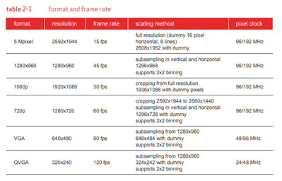

After doing this, the logic analyzer output showed about 7.5fps. This seems somewhat low, since the OV5640 camera's datasheet claims its maximum can be 120fps at the 320x240 resolution. So I wanted to ask if there are any suggestions for improving the frame rate. My company is working on a project that would like to achieve at least 720p 15fps with a similar setup.

If I wanted to try increasing the framerate even more i.e., I was trying to maximize it on this STM chip (recall my goal is 15fps but on 720p resolution), do you know if that's just simply increasing the value in OV5640_SC_PLL_CONTRL2 even more? From a quick glance at the datasheet, that's what I've guessed the PLL multiplier is somewhat, if not directly, used for.
2024-02-08 7:27 AM - edited 2024-02-08 7:27 AM
Hello @afok-esmart ,
Glad to know the initial issue is resolved. For that, Could you please click on "Accept solution" on the reply which solved your issue or answered your question?
To modify the resolution, I advise you to refer to this table in the OV5640 datasheet and to 6.4 DMA configuration in AN5020.
