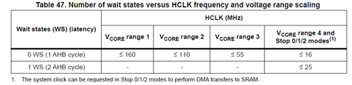

In my opinion, what is missing in this code is the setting SRAM wait states to 1 after wakeup at 24 Mhz. In RM0456 (section 6.3.4 Read access latency, Table 47. Number of wait states versus HCLK frequency and voltage range scaling), the WS must be 1 when VOS is range 4, 24 Mhz. This can be programmed in WSC[2:0] field of RAMCFG_MxCR.
However, to confirm this hypothesis, can you update your code by configuring the system clock to MSI @16 Mhz, with 16 Mhz no changes required for SRAM latency (0 WS). Then check if you still fall into a hardfault.

To correctly read data from SRAMs, the number of wait states must be correctly programmed in WSC[2:0] field of RAMCFG_MxCR, depending on AHB clock frequency (HCLK) and voltage scaling range, as shown in the table below.

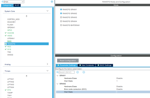

You can also follow the snapshot below of the STM32CubeMx code generator to configure SRAM WS.
