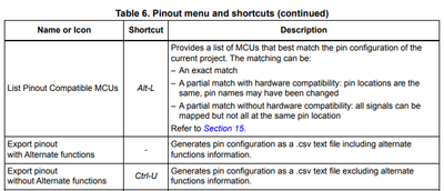

Hi @RicOs ,
I join @Andrew Neil with the idea to use STM32CubeMX.
From Pinout tab, STM32CubeMX allows to export the pinout to a csv file. You can select any STM32 part number then do the required export. This is explained in the UM1718:
-Amel

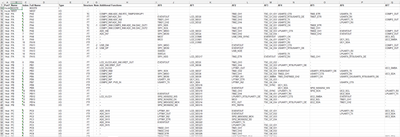

2025-01-15 3:51 AM
@Andrew Neil wrote:So not a complete listing of all the pins with all the AF options and all the Additional Function options?
@Amel NASRI something like this - see attached

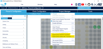

2025-01-15 5:50 AM
Just to complete @Amel NASRI 's answer, as sometime the most difficult is to find the function in the tool, below the picture to find the mention menu in STM32CubeMX.
