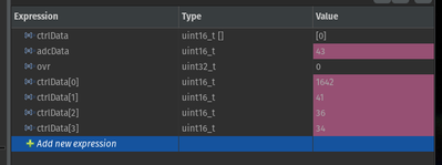

I've made some progress here. One issue was just a newb mistake using live expressions:
The expression for ctrlData just shows a zero, but if I inspect the individual elements I'm getting data.
I'm not sure if this works in the original project I uploaded. Will try to confirm if it did and I missed it or if one of the other changes I made resolved the issue, and if so what that was.
2025-05-11 11:40 AM
Rebuilt the project from the zip I included and it does indeed work. So that video workshop seems applicable to U5A5 and it was just my error in live expressions.
