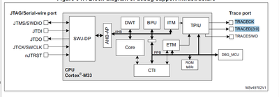

I trying to figure out what the maximum frequency is for the TRACECLK stm32u5A9.
I found this post for the stm32h5
https://community.st.com/t5/stm32-mcus-products/traceclk-freq-in-stm32h5/td-p/604127
does the same apply for stm32u5 were can i in that case find this information for stm32u5?
Are there any pcb layout guidlines for
TRACECK
TRACED[3:0]
