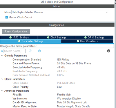

I have a board with an STM32U575 at the core.
I'm attempting to set up SAI receiver in I2S mode, with 32-bit 48kHz sampling. See my configuration of SAI A below:
I also want to receive the data continuously in circular mode via DMA (or GPDMA in the case of this MCU).
Reading other sources, I've concluded that the following setup should be established:
The audio DMA functions can be seen below. The Audio_Init() function is called once in the main function, and the CpltCallback functions are called by DMA interrupts.

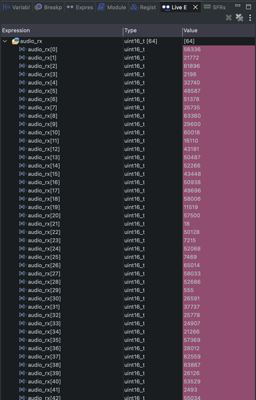

When my hardware has no audio source connected to it, I would assume that the audio data stored via DMA in the audio_rx buffer should be equal to 0 (and maybe some weak noise).
However, my buffer is filled with what appears to be 16-bit garbage values:
Why is this? I've successfully implemented this code on my old build, which used a STM32G4.
I'm very thankful for any help I can receive on this issue!

2024-02-26 10:45 PM - edited 2024-02-26 10:56 PM
You are lucky, your SAI and your ADC are working correctly.
Now your 32bit buffer shows perfect noise values around 0, with about 100 dB SNR, the least 15 to 16 bits noisy only.
Check the 2's complement data format: https://en.wikipedia.org/wiki/Two%27s_complement
Your ADC ist just noisy around 0, example for 2's complement:
8 bit 2'sc:
1111 1111 = -1 !
0000 0000 = 0
0111 1111 = +127
1000 000 = -127
When working with audio formats, you should have heard about that. ;)
If not, now you know... :D
So it was mostly a 16 / 32 bit problem.

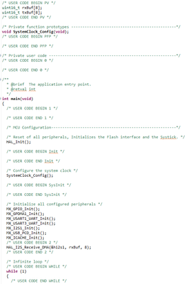

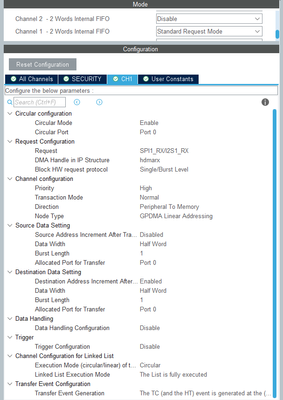

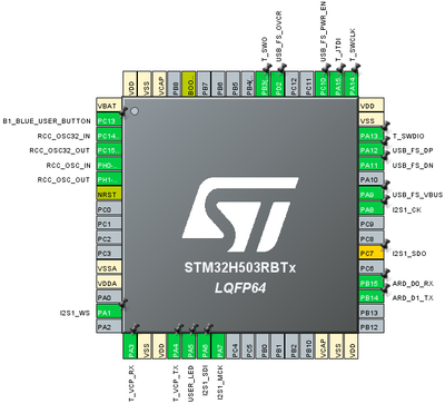

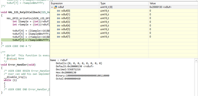

Hello, I have a similar problem with my nucleo H503RB. I'm trying to make it work with Pmod I2S2 module (ADC+DAC). For now I've connected only ADC via I2S1. This is my HW configuration:
I2S config:
GPDMA config:
Code:
Output:
As you can see, I have no data in the buffer. I've checked clocks and data line with scope and it's okay here. The DMA interrupt also fires. So what can I do with it?

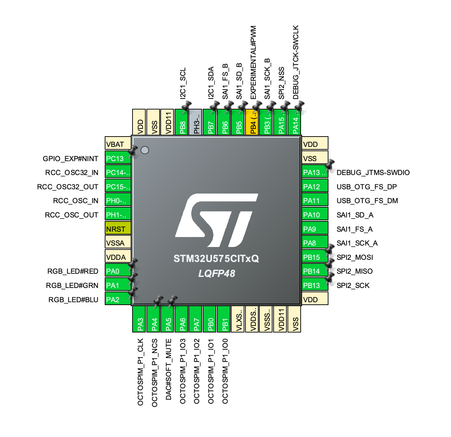

Below is the pinout on my STM32U575, if that is of any help:

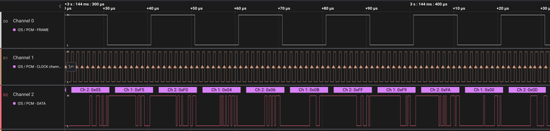

2. Here's what I'm getting on the scope. Every frame is transferred in 8 bits, which kind of makes sense when you look at the way pData is setup in this function:

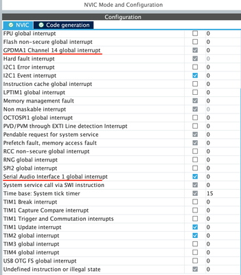

4. I've used this ADC with an STM32G4 MCU, where I used a simple I2S interface without needing a master clock. On this device, everything worked perfectly.
5. Here's the NVIC, where the ISRs are enabled both for the SAI1, and for the GPDMA channel it's using.
6. The RX data changes randomly and constantly.

Oh my, the DMA setup is completely different from the G4 / F7 / H7 that I know.
But there is definitely one problem:
SCLK should be 4 times higher for 2 x 32 clock cycles within 1 LRCK cycle, but you actually seem to set it up correctly with SAI_PROTOCOL_DATASIZE_32BIT.
I would read the SAI registers where all the clock settings are done. Maybe there's a HAL bug?
Are there any SAI examples from ST for that U575? I would compare DMA and SAI setup.
And check if your ADC really runs as SAI_I2S_STANDARD, not as left justified (as most audio ADCs that I have used).
