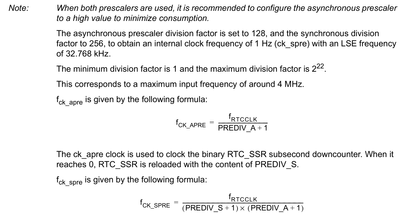

The prescalers must be changed so that the CK_SPRE happens at 1 Hz.
If you are using a 32.768 kHz clock, then you must have (PREDIV_A + 1) * (PREDIV_S + 1) = 32768. So increase one and decrease the other. PREDIV_S is not an independent knob to adjust precision.

> Is there a configuration that would allow the RTC to advance the "seconds" register every 1 second, while still keeping the SSR register moving at a resolution that allows, say 0.25ms accuracy (PREDIV_S set to 4095)?
Well, from my post, I said you need to have (PREDIV_A + 1) * (PREDIV_S + 1) = 32768 if your clock is 32.768 kHz.
If you want PREDIV_S = 4095, then let's do the math here:
(PREDIV_A + 1) * (4095 + 1) = 32768
PREDIV_A + 1 = 32768 / 4096 = 8
PREDIV_A = 7
So yes, you can have PREDIV_S = 4095 and PREDIV_A = 7.
Thanks again, TDK, for your tremendous help. I guess my math was wrong. With your recommended settings (PREDIV_A = 7, PREDIV_S = 4095), the RTC indeed advances the seconds counter as expected, while maintaining the desired SSR resolution.

According to the manual:
But it also says that ADD1S will advance the clock by a whole second, which is not desirable for my use-case.
