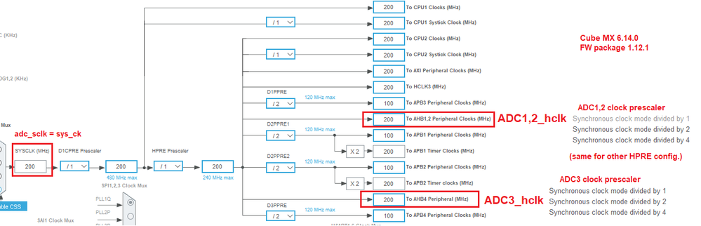

I'm always confused with the ADC clock config of H7 devices. ok, H7 is not a device for noob but ever after spending days reading datasheets, users manual, appnote, and filling spreadsheets, when starting cube MX, you will always find that the clock scheme you want to use is not available (and the one you think not reachable, is available).
I'm using the H757, BGA240+40 @ VOS1. ADC2 and ADC3 configured to sample 6 channels each in scan mode. No injected channel.

- adc_hclk is the AHB1 (ADC1,2) or AHB4 (ADC3) clock : max 200MHz. This is the clock source for the digital part only.
- adc_sclk is sys_ck when HPRE = 0 (1:1 ratio), sys_ck/2 otherwise (1:2 or more ratio). This is the clock source for ADC SAR converter (limited to 50MHz AFTER the prescalers)
When playing with the clock divider in cube MX, I can see that the ADC sync clock prescaler (1:1 1:2 1:4) are not always available). My guess was : The software allow only prescalers that make the clock <=50MHz). Right ? Let's see...
In this example, adc_sclk = sys_ck (HPRE = 0), so 200MHz.
The only sync prescaler allowable should be 1:4.
Or, for ADC1,2 1:2 is also available. For ADC3, all are available.
