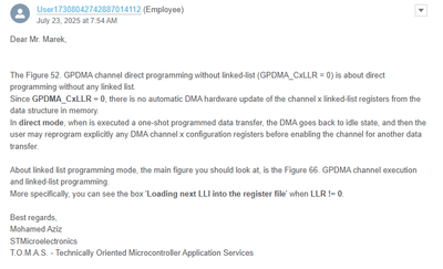

in RM0456 is plenty of examples with using LLI but only one without it. And even that contain a block diagram that does not explain anything. Also AN5593 does not mention cyclic transfer. So, here i am.
Does this diagram means, that if the LLR register is null, the transfer will automatically restarted and thus used in cyclic transfer without LLI?

Hello @Eiffel,
The block diagram you referenced shows the direct programming flow, which ends after one transfer unless re-enabled by software by configuring the GPDMA_CxLLR register
Also, cyclic (circular) transfer mode is available and does not require LLI. It is enabled via the CIRC bit.

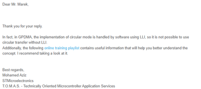

Also your colleagues from support:
What happens with ST? Even ST employees dont know what to do.

Hello @Eiffel,
The implementation of circular mode varies depending on the DMA controller. For the STM32U5 series, there is no dedicated CIRC bit for hardware circular mode management, as detailed in the product reference manual.
Instead, circular buffering is handled through linked-list programming, as explained in Section 17.4.13 "GPDMA circular buffering with linked-list programming" of RM0456 Rev 6.
To achieve circular mode, you need to create a linked list that resets the memory source (or destination) start address for memory-to-peripheral (or peripheral-to-memory) transfers. The GPDMA automatically reloads the initially programmed block size (GPDMA_CxBR1.BNDT[15:0]) upon completion of each block transfer.

Hello another ST employee.
Thanks for another opinion. Current state is 2:1 for statement, that gpdma does not support circullar mode. Instead of that, there is a way to "hack" it, because you screwed it. That means another arbitration for loading configuration for gpdma channel, while there is just one gpdma controller. Really "impressive" job.
About that "tutorial", did you watch that? Do you understand principle of gpdma from that videos? That is just a tutorial about how to click and where. Nothing about principles of gpdma.
