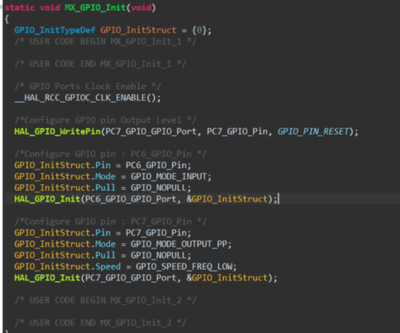

2025-06-03 3:30 AM
Hello @FBL
Is there any bug or something in Cube MX or Cube IDE because, I can chose UCPD1_CC1 and UCPD1_CC2 pins as GPIO in Cube MX and Cube IDE.
