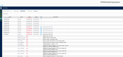

Using the STM32CUBEPROGRAMMER v2.2.0 + the NUCLEO-N657X0-Q :
I tried to set the OTP_124 -> HSLV_VDDIO3 bit to 1 but it did not suceed. First, I read the whole otp, put 1 in that field then press Write and it did not work, the OTP_124 stays at default 0x00000 . The nucleo-n6 is is dev mode (BOOT0 = 0, BOOT1 = 1).
Thank you.

2025-07-11 12:09 PM
Sorry i meant that i was using the STM32CubeProgrammer v2.20.0
2025-07-11 12:10 PM - edited 2025-07-11 12:11 PM
I tried to write the whole word but did not work.
I also did check the "Lock" checkbox and now i have the "permanent write lock", so is that bad ? can i recover from that ?
