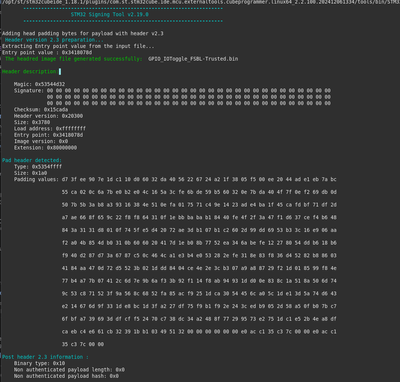

This is my build command for the GPIO_IO_Toggle application.
* /opt/st/stm32cubeide_1.18.1/plugins/com.st.stm32cube.ide.mcu.externaltools.cubeprogrammer.linux64_2.2.100.202412061334/tools/bin/STM32_SigningTool_CLI -bin GPIO_IOToggle_FSBL.bin -nk -of 0x80000000 -t fsbl -o GPIO_IOToggle_FSBL-Trusted.bin -hv 2.3 -dump GPIO_IOToggle_FSBL-Trusted.bin

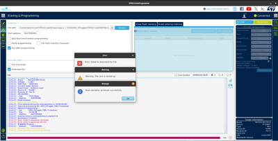

I tried this on 2 different boards and the same thing happened
Bellow is the results from trying to program it.
My output from generating the signed bin

2025-11-24 9:16 AM - edited 2025-11-24 9:33 AM
Well i guess my bigger question is this permanent or not? If not how do i unlock it?
I can still program it in Debug mode. So boot 0 -> gnd and boot1 pin to -> high. Just i can't seem to flash the chip. So i can't test larger applications.
