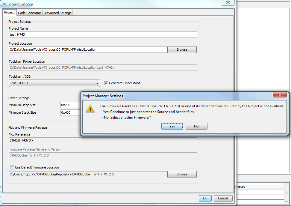

Regarding your 2 first points :
1. In general STM32Mx cube will generate drivers in the location where project file is there with folder structure drivers/STM32F7xx_HAL_Driver/src.
Can we configure path to the generate driver files?
Can we configure the name of the generated folder in the tool?
==> The drivers folder will always follow the structure drivers/STM32xxx_HAL_Driver/src.
However it is possible to set your own Project Name in Project/Project Settings and to choose the project location according to the path where you want to have the generated code.
2. In general STM32Mx cube will generate EWARM settings as well. This is not required on every change.Can we generate only source files without settings?
==> it is mandatory to choose a toolchain/IDE to generate the code.
furthermore, if you don't have the FW needed for the generation, it will ask you if you only want the source and header files to be generated. Then, click on yes.
For further details, you can read the
.I hope it will help you.
