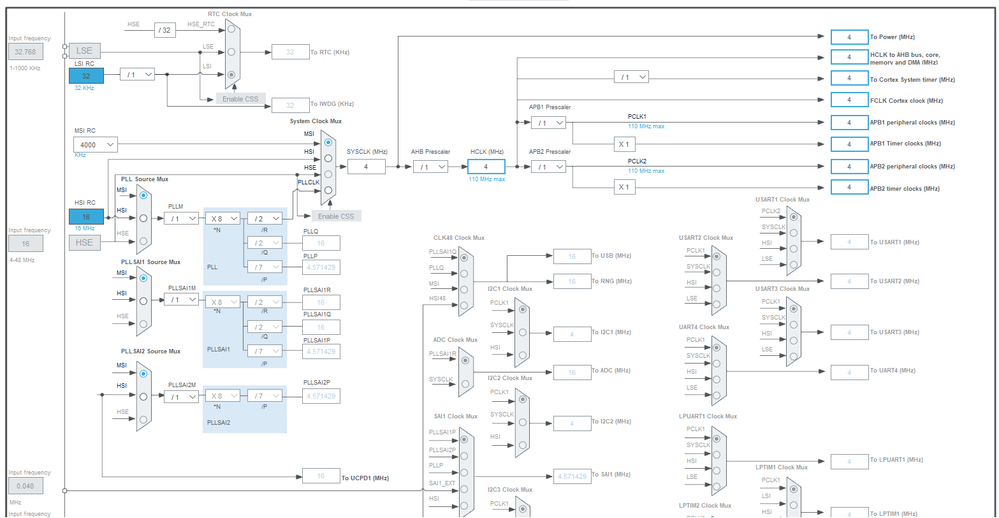

/************************ (C) COPYRIGHT STMicroelectronics *****END OF FILE****/Picture of clock generation (all default values, I changed nothing here). Usually I use max. Frequency and only HSI and LSI.
