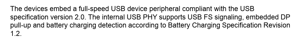

2024-03-13 9:56 AM
L552 cannot play "host" , see ds:
So to have usb host msc : need other chip, that can be "host" .
2024-03-13 9:48 AM
A USB Flash drive would need to use a USB HOST example, not a USB DEVICE one.
Not sure the L5 design facilitates that.
2024-03-13 9:56 AM
