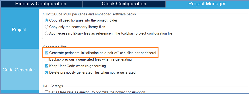

It's possible to gather the configuration generated in the two files by selecting the "Generate the peripheral Init as pair of '.c/.h'.." option as mentioned in the image below.
