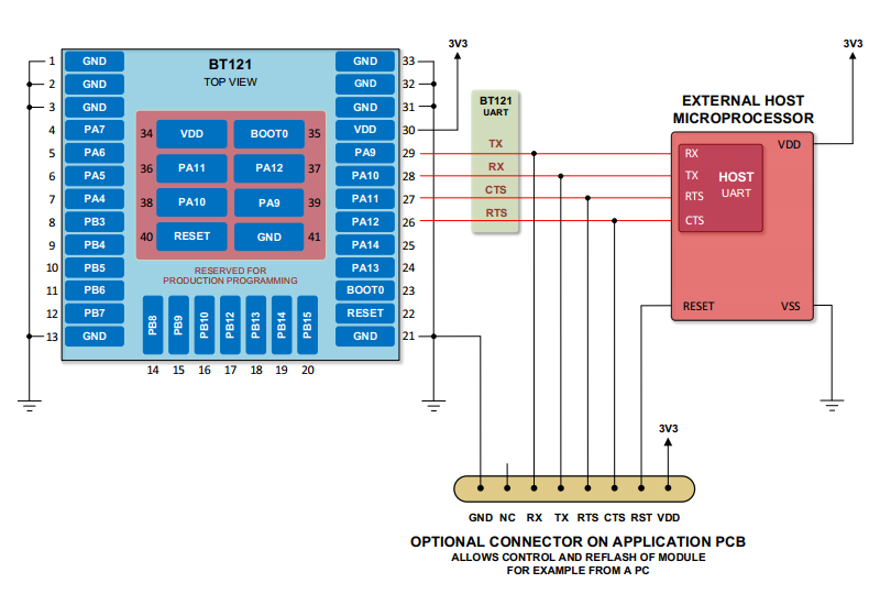

I'm using a dev kit offered by SiLabs, DKBT, to program the BT The dev kit acts as a USB to UART converter to interface the UART on the BT

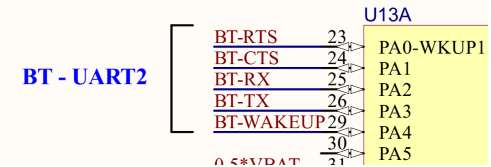

On the MPU host side I have PA0 to PA3 configured as UART as follows:
When programming the BT121 the datasheet advises to keep the host MPU in reset state to keep lines floating.

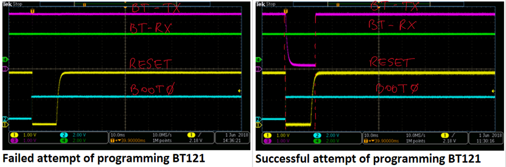

Following capture is for the TX (pink), RX (green), RESET (yellow) and BOOT0 (blue) pins on the initial reset dip that puts the BT121 in the DFU mode which allows me to program it.
NOTE: Reset and BOOT0 are the pins on the BT121 chip and not the STM micro.
What I'm seeing from the captures is that a failed attempt to program the BT121 is caused when the BT-TX line does not go low in line with the RESET pin.

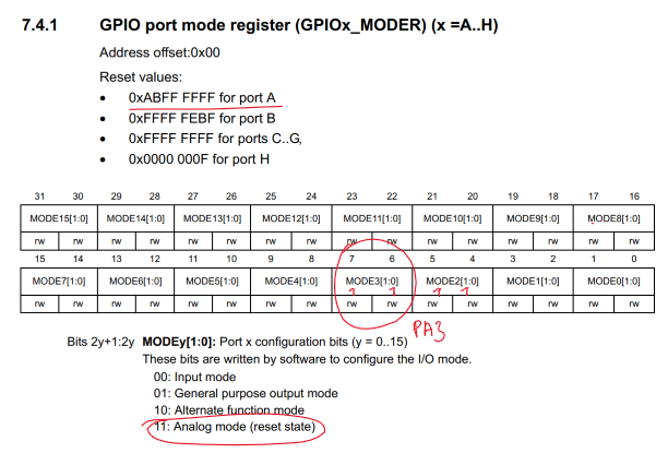

From my understanding on an erased MPU all the lines (except the JTAG pins) are supposed to be configured as analog input floating. I verified that with the reference manual:
I went ahead and programmed the specific pin on the MPU as analog mode then as input Push-pull and both seem to work, I was able to program the BT But then I realized that even if I flash and empty program into the MPU the programming of BT121 works.
Finally, Ifigured out that by just simply connecting to the MPU via the ST-Linkto the JTAG brings the MPU into a state where I'm able to program the BT121 chip.
Am I missing something? By the looks of it PA3 is not configured as floating analog inputwhen completely erased.

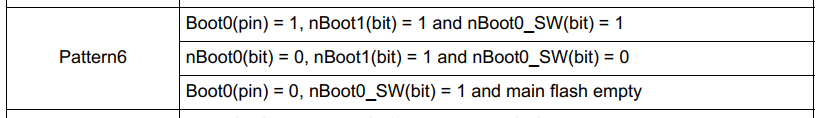

Considering the table 2 from ther AN2606 app note:
The Boot0 pin in my application is pulled low and the main flash is empty (erased). I don't think I set SW Boot0 pin in any way since the issue is found on a untouched (fresh) micro.
The embedded bootloader enables the HSE and this is not happening in my case.
