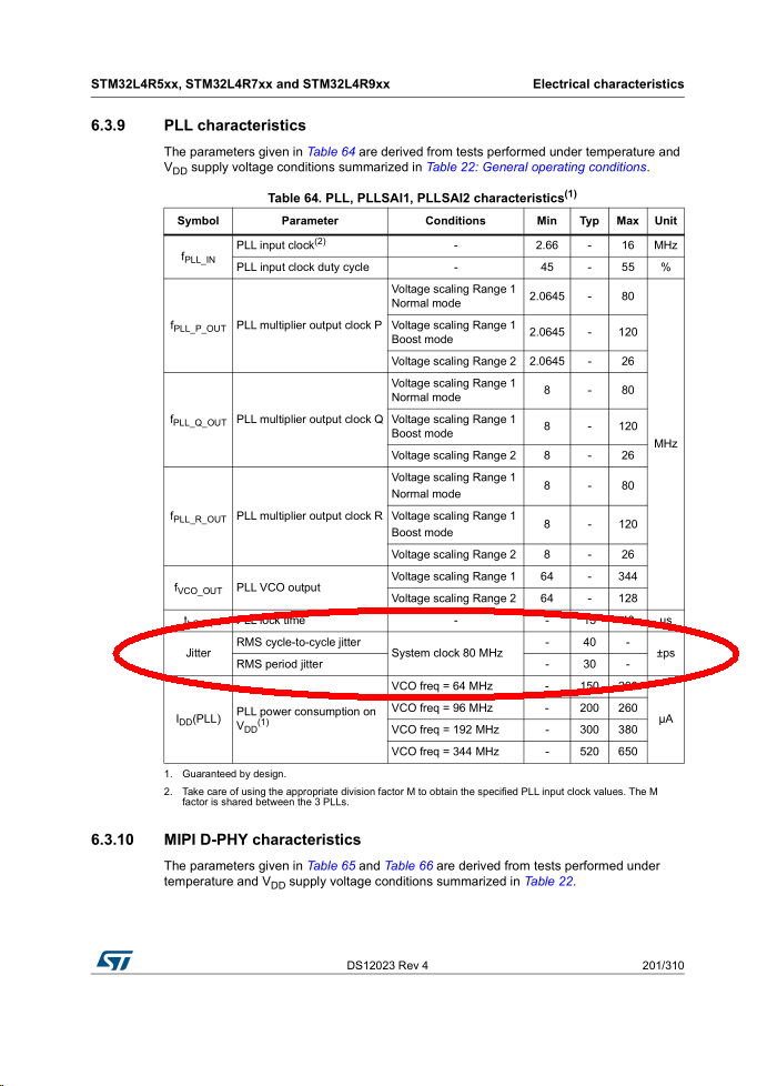

This probably depends on exact definition of what "accuracy" might mean, but IMO generally, accuracy of PLL is given primarily by accuracy of the driving clock, i.e. here the crystal oscillator or external oscillator used.
Jitter is another thing. It is *somehow* characterized in the DS:
