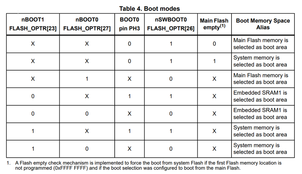

2020-09-09 3:31 AM
Verify the value of nSWBOOT0 if it's set, with the BOOT0 is 0 and when the flash is empty the system will boot from the system memory. You can check table 4 Boot modes of the reference manual to see the different boot possibilities.

2020-09-09 3:47 AM
Yes, nSWBOOT0 is set. But how it considers Flash empty, because am just modifying the configuration value that needs to be written on Page 1/Bank2.

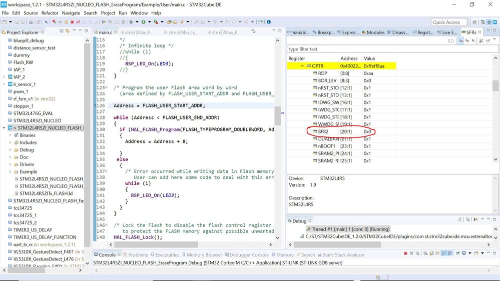

2020-09-09 4:25 AM
Can you share the configuration of the FLASH_OPTR register and your main if it's possible? I want to check if the bit BFB2 is set or not.

2020-09-09 4:33 AM
HI,
Pls find snapshot of the FLASH register below , taken in debug mode: BFB2 is RESET, so dual bank boot disabled.
