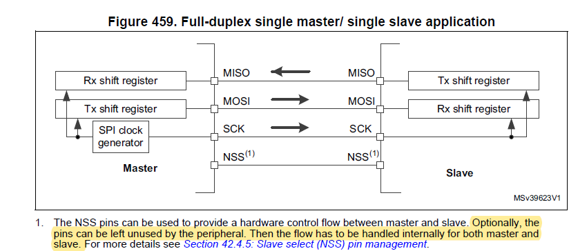

I have highlighted in yellow the statement which has been confusing me.
"Optionally, the pins can be left unused by the peripheral. Then the flow has to be handled internally for both master and slave"
Here it is mentioned "then the flow has to be handled internally for both master and slave".
Which puts a question in my mind that either both slave and master use internal bits for their SSL configuration
OR
if Slave is not configured using internal SSL configuration, use an explicit GPIO pin.
Please correct my understanding.

The peripheral and its signals can be routed to GPIO through the alternate functions... or not.
So you should just select any GPIO as push pull output and drive it by SW to become the master's NSS.
The peripheral guts is like the brain without all nerves connected to muscles...
The drawing Figure 459 is misleading as it simply says if you know what you are doing and you don't need to get NSS to tell you the start and end of message, then you can forget it, which is rarely the case: a simple bus glitch and all your data maybe few bits shifted... and what happens if the slave is reset or the master is separately reset? boum!
You can set the SPI as you said, and not activate the alternate function to let the signal out. Then use the corresponding GPIO simple Set/Reset output level to generate the NSS. Use PA5 (or any pin you wish) as push pull output (mode=01) to generate the NSS for the slave.
