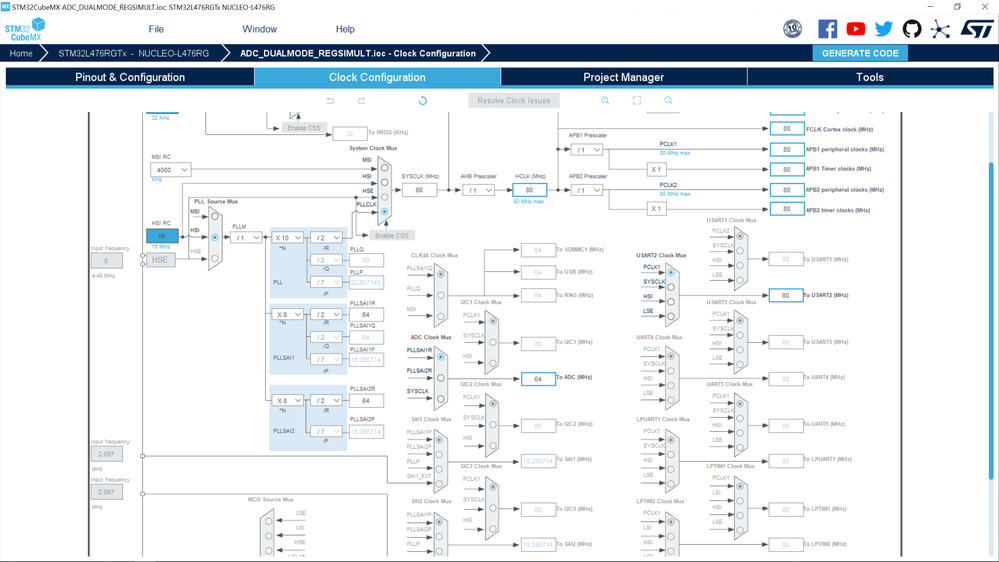

Hello @AKhot.1,
You can get started with this example STM32CubeL4/main.c at master · STMicroelectronics/STM32CubeL4 · GitHub
Also, if you set ADC prescaler asynchronous clock, you are using these options.
Otherwise, if you set synchronous ADC prescaler, it should be greyed out.
