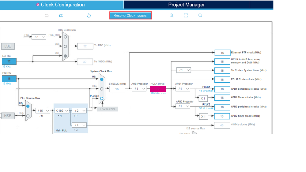

Hi, I tried following the instructions in the presentation with the latest CubeMX 5.0.1, but when I got to Generate Code it popped up a message "These IPs still have some not configured or wrong parameter values [Clock]. Do you still want to generate code ?". Is that something that can be ignored for this example ? Thanks.

You have to configure the clock before generate code.
You can click on the "Resolve Clock Issues" button to resolve automatically your configuration issues .

Hi again, so I finally got to try the Resolve Clock Issues button. After double-checking that I've set everything as specified in the "STM32L4 Discovery USB VCP hands on.pdf" that Szymon linked to, when I click Reslove Clock Issues it pops up "Cannot found a solution for some constraints".
2019-01-31 8:26 AM
Update - When I was getting the Resolve Clock error, I had created the project by specifying the board (STM32L476 Discovery, a.k.a. STM32L4-Discovery, a.k.a. 32L476GDISCOVERY). I went back and started a new project, specifying the CPU this time (STM32L476VG) rather than the board, did all the setup, and there were no Resolve Clock errors this time. Code was generated and ran successfully on the board.
