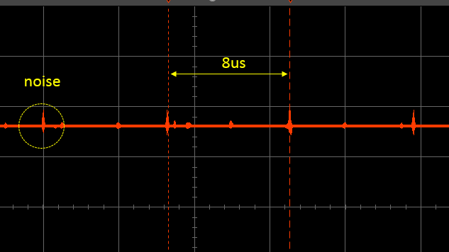

I'm using STM476 for reading ADC value.
If I try to read ADC ch continuously, I can see some noise at ADC port.
The ADC sampling time is set as 650 cycles at 80MHz clock speed and the noise interval is same with the ADC conversion cycle(8us).
ADC configuration is same as below. Could you give me some advice about this?
