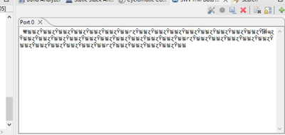

I have followed the previous recommendation and enabled debug message in cube ide setup and enabled SWO in debug configuration. But, when I tried to print a sample string "Hello" I got some junk values. Could you please confirm if there is any other configuration?

Currently looking at pulling log information via SWD, even though message comes out, its all scrambled , why would it be?  clk issue ?

SWO output looks like wrong speed setting.
Did you set the real cpu core clk frequency in debug ?

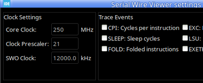

Ok, and also correct clock in debug -> swo settings ->
(here on H563 at 250M )

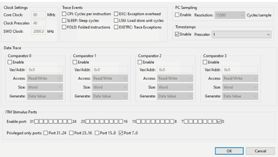

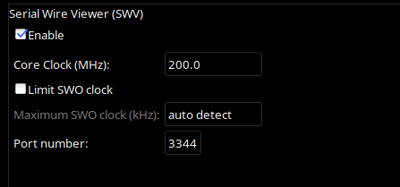

Below are the settings we done
